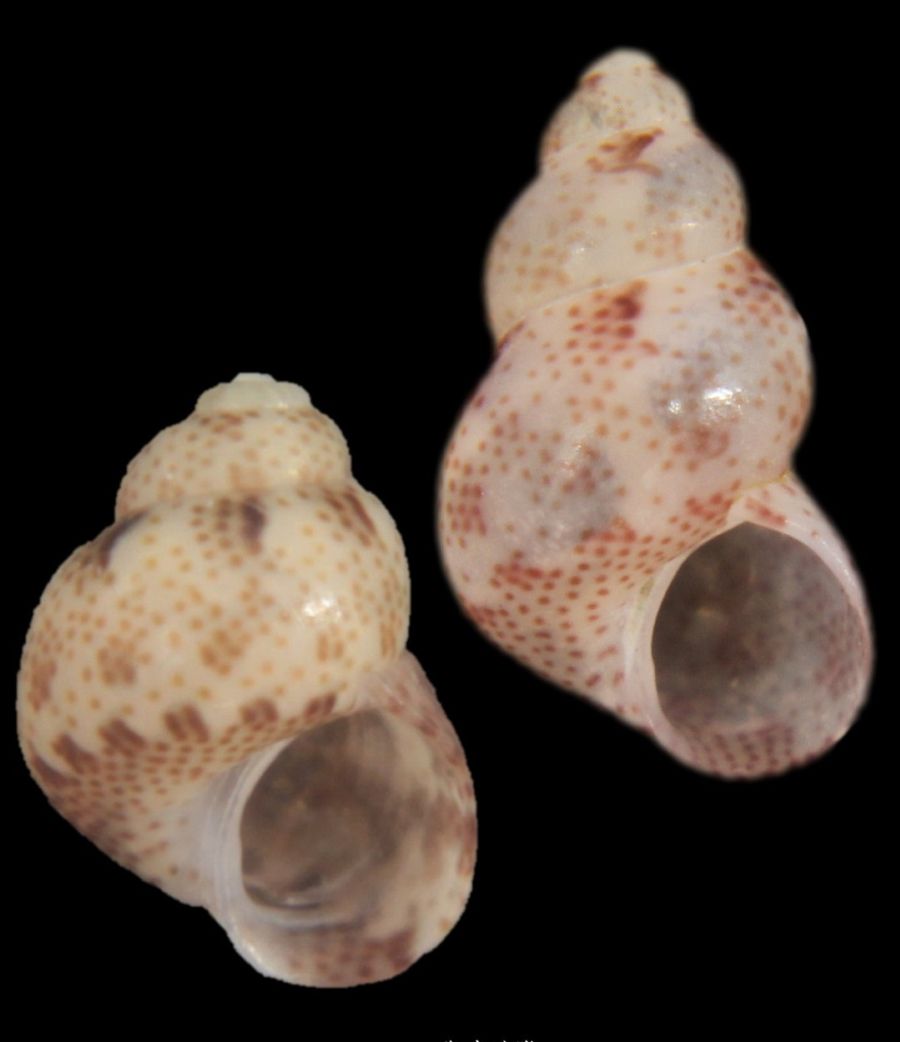

上圖這種雉螺目前僅發現於桃園藻礁海岸,殼長約3mm,外觀和尺寸皆與多變雉螺Hiloa variabilis相近,差別在於本種殼體呈立體直筒狀,而多變雉螺比較矮胖.菲律賓圖鑑給的學名是Tricolia fordiana,但尺寸標10mm,實在有點誇張.個人的疑問是:
1.學名Tricolia fordiana正確嗎?
2.尺寸10mm可能嗎?
3.會是多變雉螺的型態變異嗎?(個人覺得不是)
請站長撥冗解惑,謝謝!

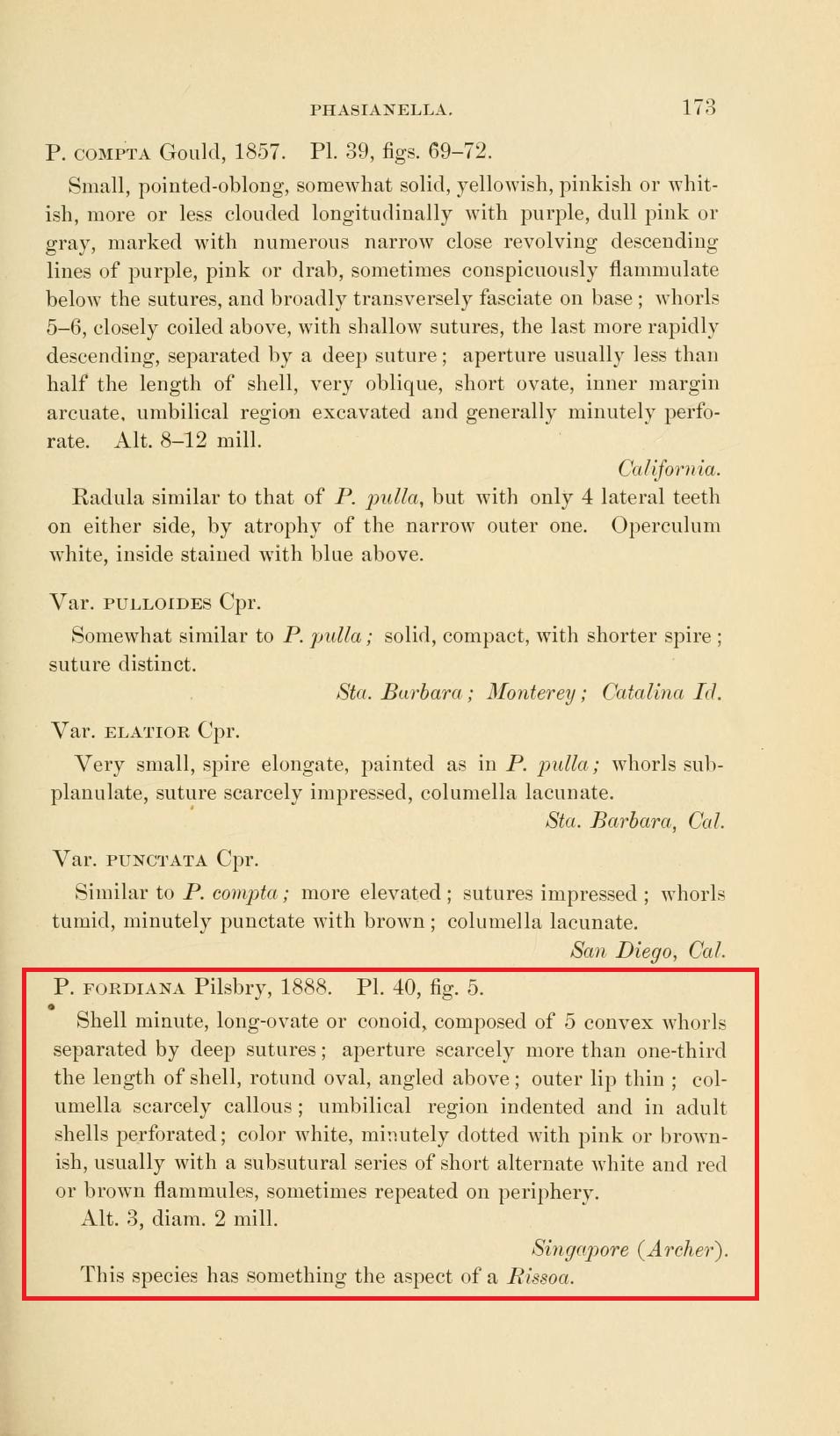

Tricolia fordiana (Pilsbry, 1888) 目前還是有效學名,它與Hiloa variabilis差不多大,菲律賓圖鑑標示10mm,基本上不可能。
我找到了原始文獻,上面的描述是這樣的:
Shell minute, long-ovate or conoid, composed of 5 convex whorls separated by deep sutures; aperture scarcely more than one-third the length of shell, rotund oval, angled above; outer lip thin; col-umella scarcely callous; umbilical region indented and in adult shells perforated; color white, minutely dotted with pink or brown-ish, usually with a subsutural series of short alternate white and red or brown flammules, sometimes repeated on periphery.
Alt. 3, diam. 2 mill.
從這描述中來看,陳老師這顆貝殼很可能就是 Tricolia fordiana,
但也不能排除是Hiloa variabilis的變型。
因為有一段文字是deep sutures,不知是有多深的縫合溝才算deep,這點我無法確認。
https://www.biodiversitylibrary.org/page/11034500#page/179/mode/1up
